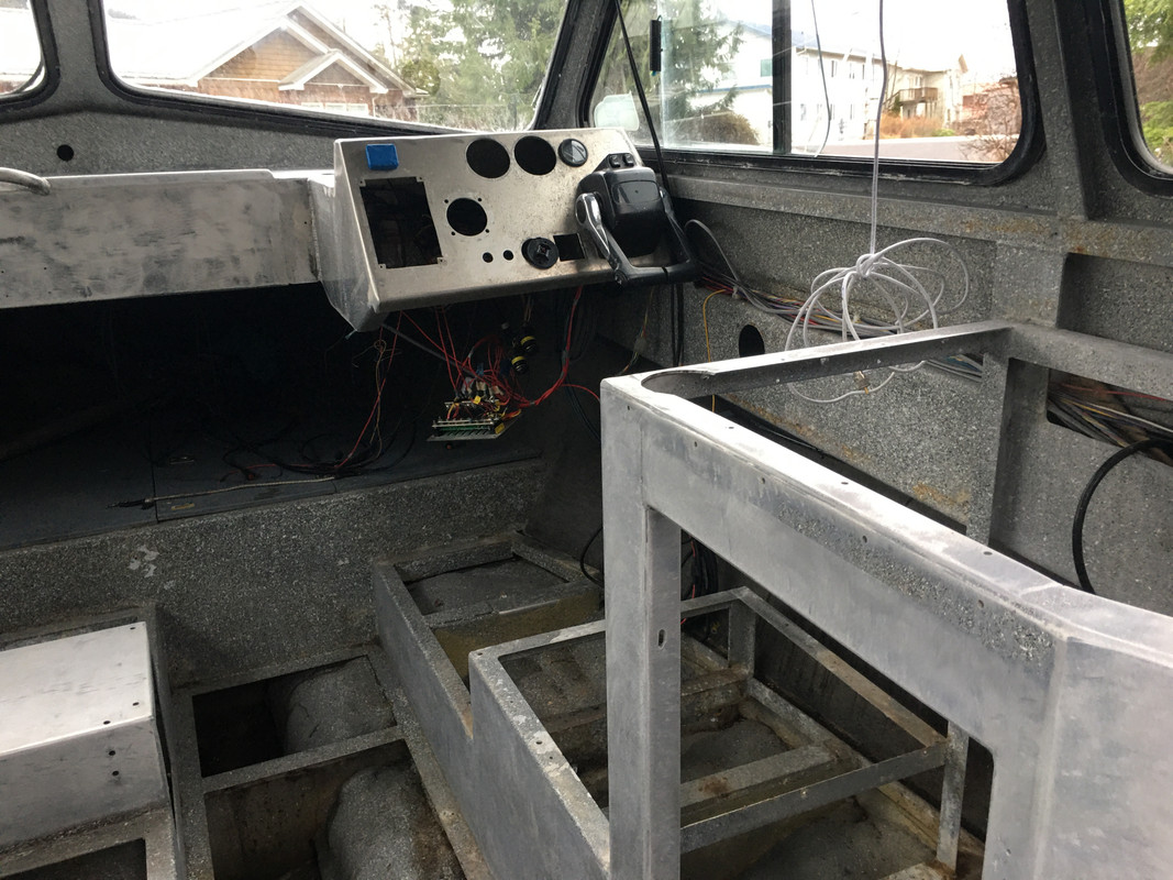

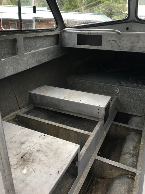

After about 160 work days, 3 moose hunts, and a pile of recreational days on the old Almar it’s time for a little sprucing up. 900+ hours on mains. I never did do much when I did the conversion 4 years ago. Phase one was to take everything out. I had neutral tongue weight after I got all my crap/seats out. Went to the paint shop today for new zolatone in the interior.
When it’s back next week it will be new headliner, carpet, and non skid. Really not looking forward to putting it back together.
a few “before” pics.

Nonskid...mask it off like you mean it, and take it to the guy who has the most vicious sandblaster around. Do the deck, gunwale tops, swim step, roof and top of the bow with big grit. Nobody will accuse it of being pretty after that, but xtratufs stick to sandblast like glue. Don't let them fart around with the little compressor and the little hopper...factory almar nonskid can be stubborn with a paint-prep blaster, as my local boatyard found out.
That's a LOT of foam under there...pull some off in the bilge and make sure the hull metal is hunky dory. Bet it's a quiet ride inside!
Any interior mods?

I have taken a little foam up. It looks ok. They foamed the crap out of these boats. Quiet but it certainly keeps you from seeing what’s happening down there. Probably going to stick with the matson non skid. I can knock it out in a few hours for about a bill in materials.
might add a screen to the back deck is all I am changing right now.
